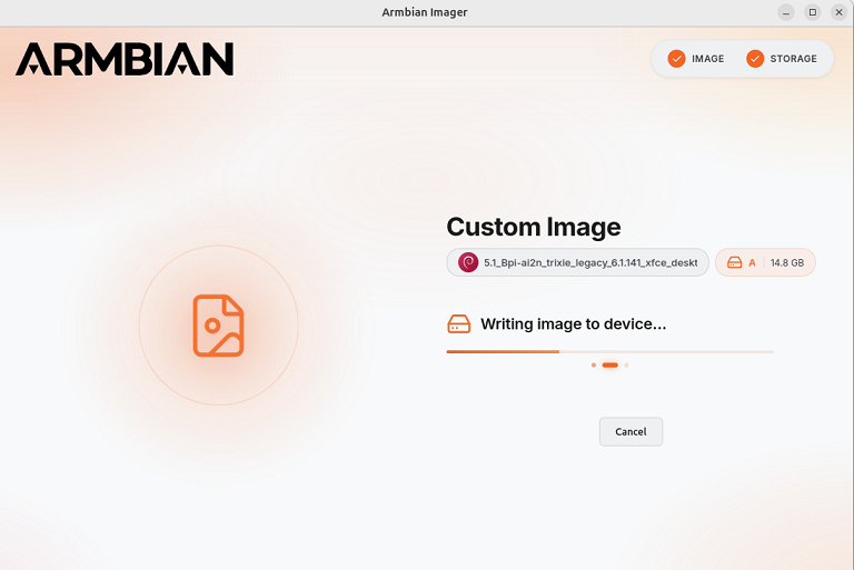

Install Image with Armbian Imager on Windows, Linux and MacOS.
Armbian Imager is an open-source imaging tool for installing Armbian OS.
For un-official board images, please select Use Custom Image→Browse and select the local image file→Select the target storage→Erase&Flash.
