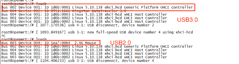

The BPI-RT2 is equipped with a USB 3.0 interface. You can detect both USB 3.0 and USB 2.0 devices when connected。

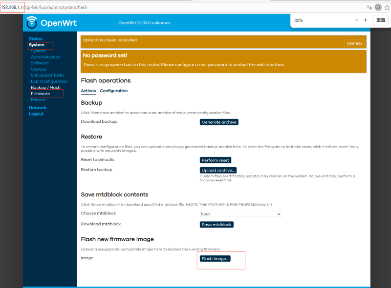

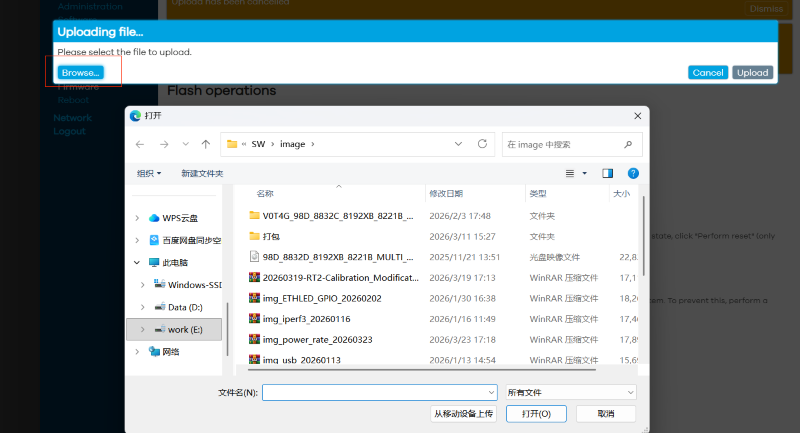

First, download the image what you want to upgrade
Power on the BPI-RT2 and connect it to the computer using a network cable.
Enter the webpage (default IP is 192.168.1.1,the user is root and does not have a password.)
Select “System", then select "System"→"Firmware".
Then, Click Flash image.
Select the image you want to upgrade, and then click "Upload".

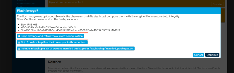

Uncheck "Keep settings and retain the current configuration".Select "Continue.
Wait a few minutes, after the upgrade is completed, it will automatically restart and the web page will automatically refresh.

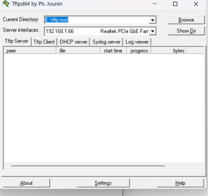

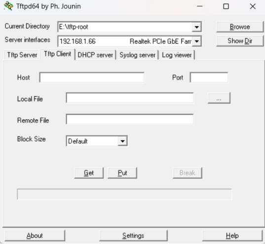

Download the TFTPD64 tool
Connect the computer to the board using an Ethernet cable, then check the board’s IP address in boot mode.
Execute printenv.
Then modify the computer’s IP address (the last host number of the computer’s IP must be 66) Change it to be within the same subnet Modify it as follows:
Launch TFTPD64 and place the file to be transferred into E:\tftp-root. If this folder does not exist, create a new folder named tftp-root on the E drive. Under Server interfaces, select 192.168.1.66. Host: Enter 192.168.1.6 (the board’s IP address). Local File: Click the adjacent … or Browse button. In the pop-up window, navigate to and enter the E:\tftp-root folder. Select the file to be transferred and click ‘Open’. Leave the remaining settings unchanged.

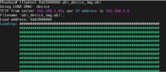

Execute the following command at the serial port:tftpboot 0x82000000 ubi_device_img.ubi (The filename 98D_ubi_device.ubi must match the selected file in Local File exactly) Upon observing the prompt ‘Loading…’ or ‘TFTP from server…’ appear in the serial port, immediately click the Put button within Tftpd64 using the mouse.
Board serial input: run updev

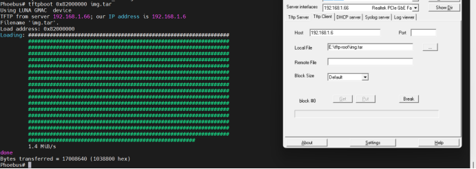

Upload img.tar again. The procedure is similar to the above.
Board serial input: run upt Finally, simply restart.

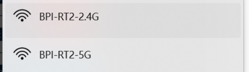

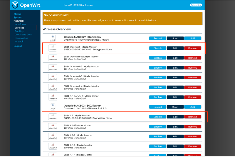

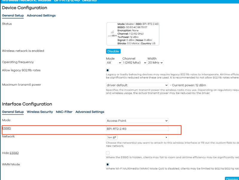

You can check the WiFi startup status in the Network’s wireless section. Among them, BPI-RT2-2.4G and BPI-RT2-5G are the WiFi of BPI-RT2. You can also make the configuration in the "Edit" section.
You can change the router’s ESSID
After the modification, you will see
