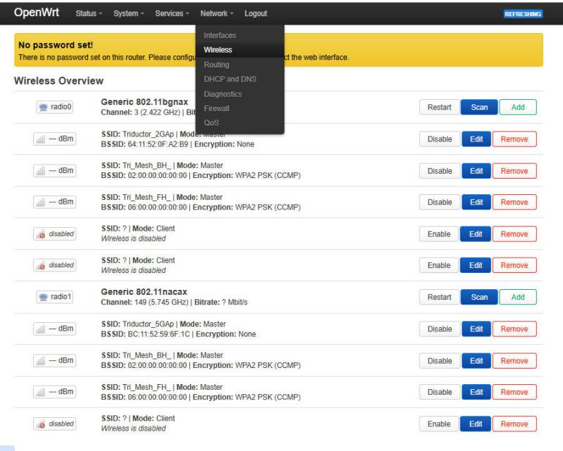

You can check the WiFi startup status in the Network’s wireless section. Among them, Triductor_2GAp and Triductor_5GAp are the WiFi of BPI-WiFi6. You can also make the configuration in the "Edit" section.
