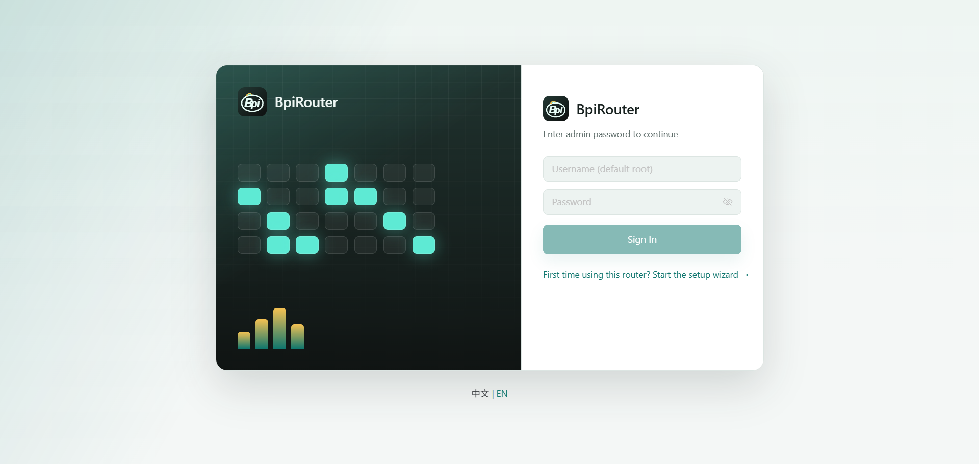

After installation, connect a computer to a LAN port and open
https://192.168.100.1. Complete the setup wizard and choose your administrator
and Wi-Fi passwords. The interface offers English and Chinese, light and dark
themes, and layouts for computers and phones.

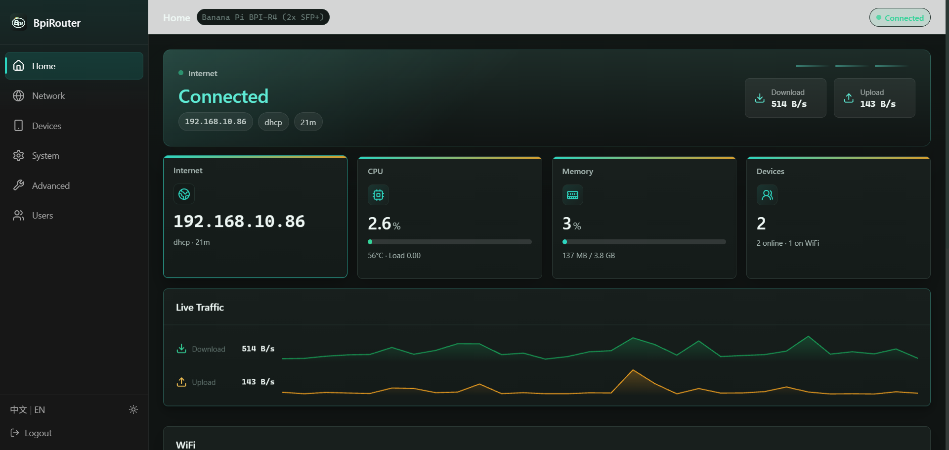

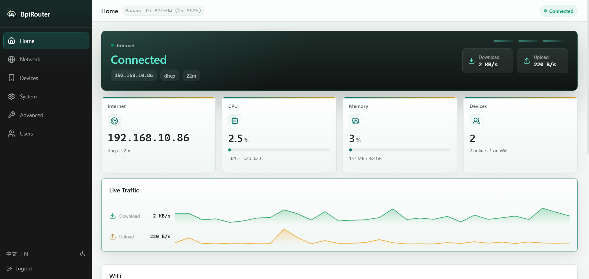

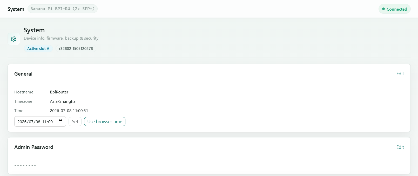

Find the product version in Home → System or at the top of System.
For this release it is BpiRouter v1.5.0-rc1. The separately listed OpenWrt
version is not the BpiRouter product version. If the version is unknown, do not
assume which release is installed.
| Page | What you can do |
Home |
See Internet status, traffic, connected devices, Wi-Fi and router resource use. |

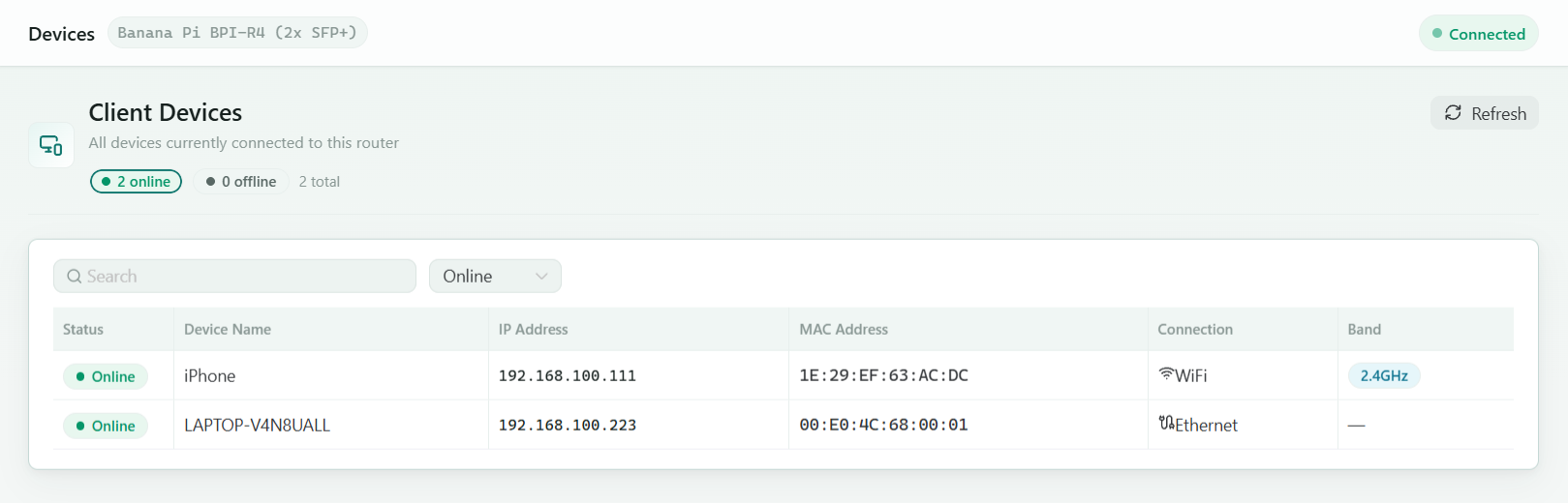

Devices |
Identify connected devices, give them names, and allow or block their access. |

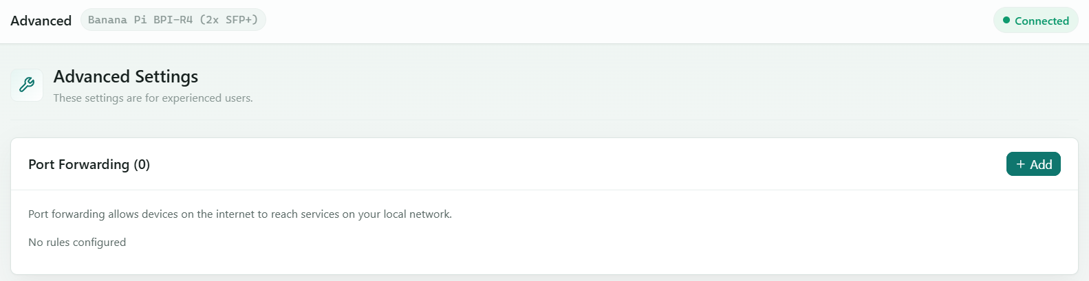

Advanced |

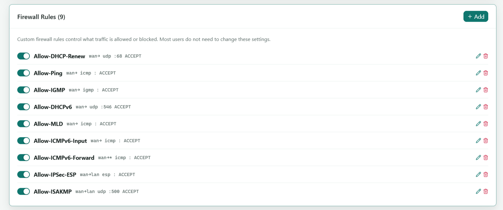

Configure DNS filtering, access schedules, port forwarding, firewall rules, VPN and dynamic DNS; use network diagnostics. |

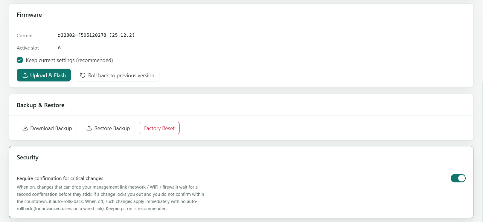

System |
Change the router name, time and password; back up or restore settings, manage firmware, reboot or reset the router. |

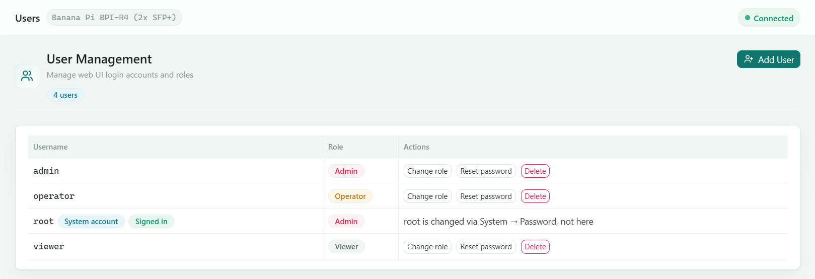

Users |
Manage administrator, operator and read-only accounts. Administrator access is required. |

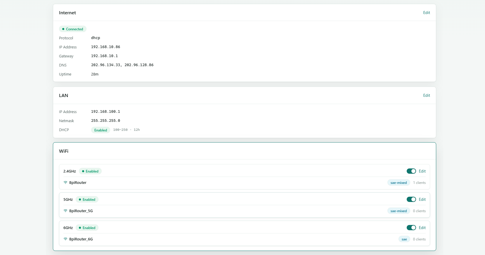

In Network, choose the Internet connection and supply the details required by your provider. Wired connections include automatic addressing, a fixed address and PPPoE. IPv6 requires support from the provider and connected devices. You can also use a compatible mobile module or a phone with USB tethering enabled.
Edit a Wi-Fi network to change its name, password and radio settings. Only the bands fitted to your board are available. Channel and 6 GHz availability depend on your country setting and client support. Changing Wi-Fi settings can disconnect wireless clients; use a wired connection when making these changes.

In Devices, use Allow or Block to change a device’s access. A device name or address is a management aid, not proof of who is using it. Access schedules and DNS filtering are available in Advanced; DNS filtering cannot block every application or every way of reaching a website.

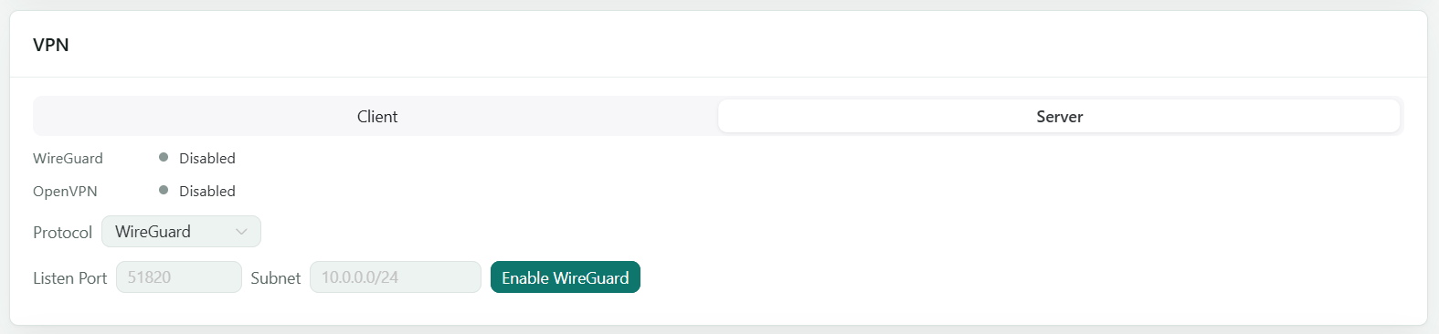

In Advanced, administrators can import a WireGuard or OpenVPN client configuration to connect to a VPN, configure a VPN server and create client configurations. Remote access requires a reachable Internet address and suitable provider/network settings; a VPN server cannot bypass a provider’s restrictions on incoming connections.

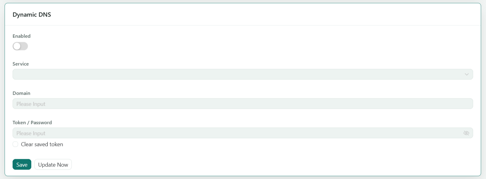

Dynamic DNS associates a domain with your changing Internet address. Choose DuckDNS, No-IP, Dynu, Cloudflare or FreeDNS and fill in the credentials requested for that provider. Requesting an update does not guarantee provider acceptance; check the domain before relying on it for remote access. Dynamic DNS does not make an otherwise unreachable connection reachable.

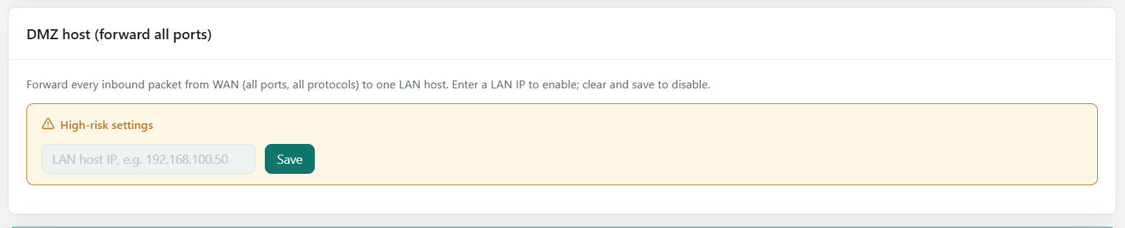

Only expose services you intend to make public when configuring port forwarding or firewall rules. Keep an alternative way to access the router while changing network access settings. If a confirmation countdown appears, confirm only after checking that the connection still works.
Download a settings backup from System before significant changes. Backups may contain passwords and keys: store them privately and do not send them with a support request. Firmware updates, settings restore and factory reset are administrator operations. A factory reset removes your settings.
For v1.5, install from the matching installation media rather than upgrading an older or another vendor’s firmware in place. Follow the [installation guide](INSTALLATION.md); an upgrade image is not initial installation media.
